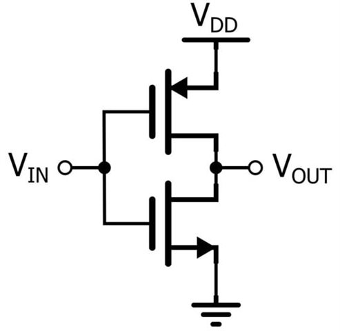

    IOH and VOH are related. In this case, IOH = VOH / RO, where RO is the impedance of the output pin.

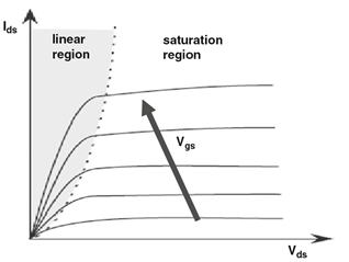

    The above is a picture of a CMOS driver. When the output voltage VOUT is high, like it is for the IOH test, the top PMOS transistor is operating in what is known as the "linear region". This means the PMOS transistor acts like a voltage-controlled resistor, where the current and voltage across the MOSFET have a mostly linear relationship:
    CSD19538Q3A: Saturation or Linear Zone? - Power management forum - Power  management - TI E2E support forums
    Obviously, when you have more current, you will have a larger voltage drop across the PMOS transistor. This is why, at -16mA, the minimum VOH is 2.4V, whereas the -24mA test current indicates a 2.3V VOH. A logic device at 3.3V VCC will not always have a 3.3V output. The output voltage is determined by ohm's law, and the IOH and VOH characteristics are provided to determine how much current the device is able to source to maintain a reasonable logic-level output voltage.
