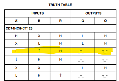

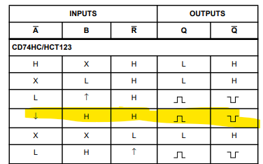

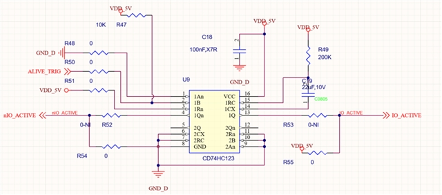

Hi team,
customer wants use the device to achieve for detect MCU work or not.
could you help to check the schematic can work or not?

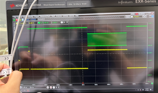

customer test the circuit but yellow waveform is going to High.
How to remove the Yellow signal because will cause MCU error detection
