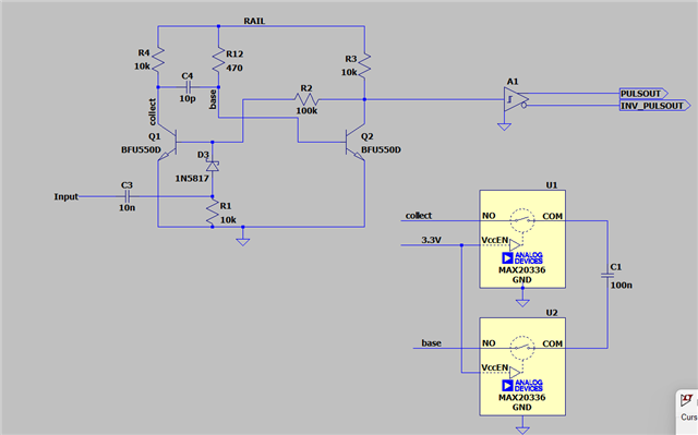

I need to design a Cct that can generate a one shot pulse from a rising edge or longer input pulse. The Cct must allow the Pulse width to be varied from 5ns to 500ms.
I've looked at various discrete solutions such as a BJT Monostable Multivbrator CCt that uses a switch to increase the capacitance and hence increase the pulse width. See LT spice image. The Cct simulates and works across the desired range in LT spice, but when breadboarding the CCt using RF BJT BFU550D the circuit fails to work at pulse widths below the uS range.

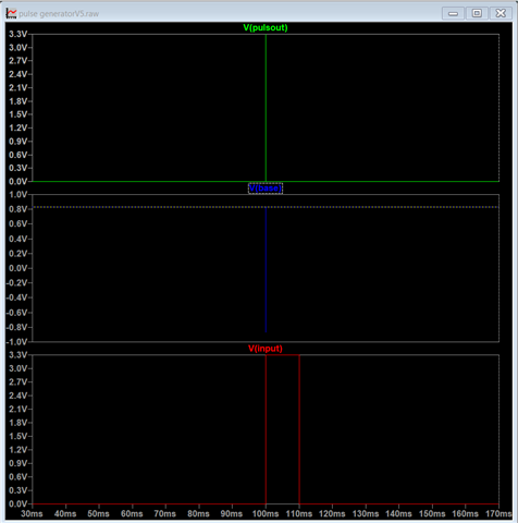

When a step is applied at the input the voltage at the node 'base' should drop from a Vbe (0.8V) to a negative voltage which in turn switches off Q2 and causes the output to rise to the the Rail voltage see screenshot below. In practice the base node is 'stuck' at vbe and hence the Cct isn't working.
After some head scratching I've noticed the rising edge of the input signal is in the us range (I'm using a pretty old signal generator - Black Star Jupiter 2000), If I change the input signal rising edge to say 2us in my sim the Cct also stops working as the base node voltage doesn't fall below the Vbe threshold of Q2.
So the Cct requires a very fast rise time on the input signal to generate <10ns Pulse widths. This means that between matching circuits on the same PCB there may be differences in the pulse widths seen due to the difference in tracking to each pulse generator Cct.

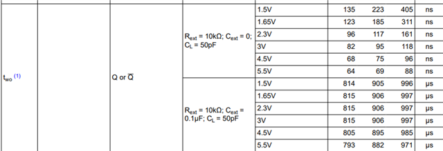

    I actually talked to the systems engineer that worked on this device. Table below is from section 5.7
    These are pulse width values with Cext = 0. I am not entirely sure what Vcc you would be using, but lets say Vcc = 3.3V. A typical output pulse would be around 95ns.
    Realistically, if you lower Rext to 1k instead, you can get a width that is 10x smaller. Resulting in ~8-10ns Only issue is while this may be achievable, it might vary more than specced (normal variation of 5-10%).

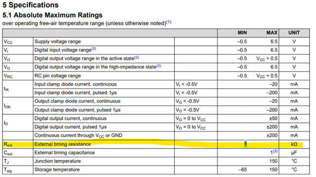

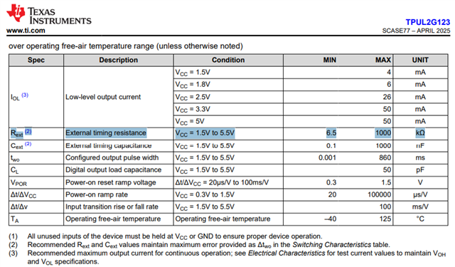

    Thanks for the quick reply on this. Looking at the datasheet for this part (TPUL2G123) I see that there is a min & max requirement for Rext & Cext.
    The recommended operating table states Rext min = 6.5k
    The Abs max table states Rext min = 1k
    This may be a suitable solution If I can get it to produce 8-10ns Pulses in practice. I was planning to use VCC = 3.3V, but looking at the table maybe a 5V supply would be better as min Pulse width decreases with higher VCC.
    As it's a test PCB we can get away with using 1k Rext i.e outside of the recommended operating range although I wouldn't want to do this for a production board.. The 10% variation is ok for this application. I'll order some of these devices and test the theory on the bench

  • Hi JLF,
    1. I checked and went through the process myself and you should be able to order samples. Can you try again? I see inventory of 3000+ currently.
    2. Regarding min/max Rext, compared to other specs such as voltage, there is potential damage to the device if you go outside of the range. However, the min/max value for Rext only pertains to the accuracy of the device in this case. Hence why I note that the variation may be a lot larger than 10% if you go under the recommend 6.5kOhms.
