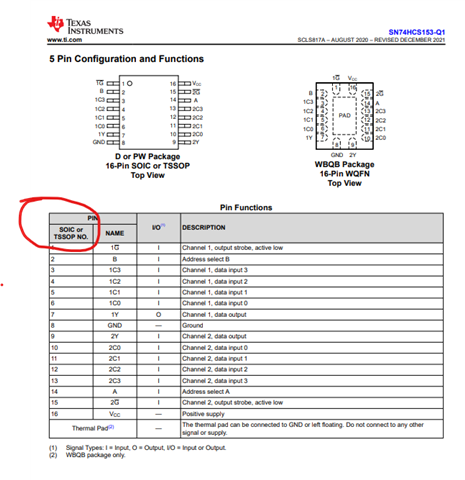

We Try to Create the Schematic Symbol for IC = SN74HCS153QWBQBRQ1 (WQFN Package ) Pin Configuration and Function what you guys Mention in the Data Sheet only for SOIC and TSSOP Packages, but their no Pin Configuration and Function Details for WBQB Package, 16-Pin WQFN Please Provide the Pin Configuration and Function Details for WQFN Package for reference i attached the Data Sheet and Image.
www.ti.com/.../sn74hcs153-q1.pdf
