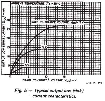

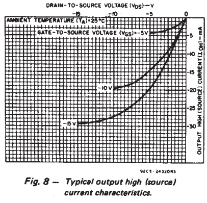

I am looking at the datasheet and it only provides minimum source and sink current. I am looking for maximum output current for sourcing when it is at high. What is that value?

Hi Marzieh,
Looking at this DS this device is very old, and it doesn't look like we have this information for this device. The best I can provide is the tables for typical output currents.
