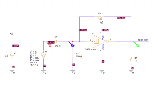

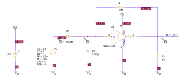

  • I have reduced the simulation to just the relaxation oscillator, but what I'd really like to simulate is a larger circuit with an amplifier chain coupled to that oscillator.
    PSpice for TI schematic for the simplified circuit here.

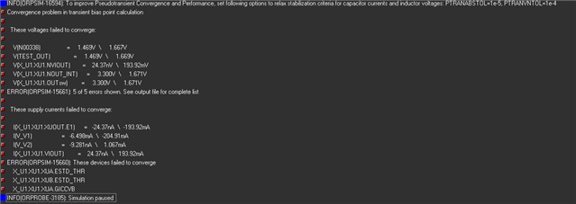

    After a few hours of running the transient simulation, I get a pop-up window that asks me if I want to change any settings. If I dismiss that window I note that the simulation is paused with these errors:

  • When I lower the load impedance (from 1G to 1M) on the output, the simulation executes very quickly.
    When I disconnect the diode and the pulse source which is used to "kick-start" the oscillator, lower the feedback resistor to 100k (and increase the capacitor proportionally to 220n) and remove the output impedance, I actually get oscillation.
