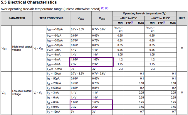

As per the datasheet of SN74AXC4T245RSVR level translator IC, the VOH and VOL values are provided for 1.65V and next voltage is 2.3V, But in our application we are providing a 1.8V at VCCI.
Could you please provide us with the VOH and VOL values for 1.8V at VCCI?
