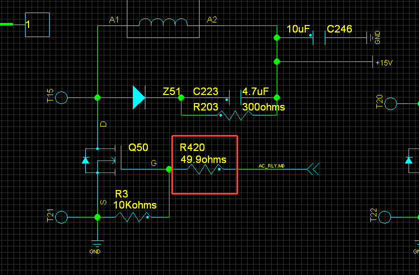

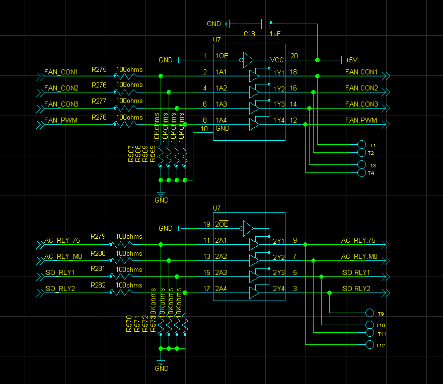

My customer is using SN74HCT244 to drive MOSFET and pin7/9 are short to GND. Q50 is YJM05N06A or AP9477GK.
Could you please help find the reason:

Issue rate is 6/1000. When customer replace issue devices with new devices, circuits will work normally.

For 1. do you know what the current is going into the MOSFET? The max of the device is only ~6mA, and from what I calculate with 5V on the output, it is actually around 100mA right now.

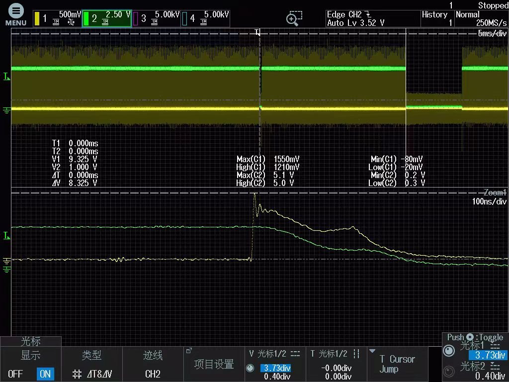

Please see the picture.
Q1: What is current peak value and duration time?
Q2: Why it is limited by 6mA. Due to internal push-pull triode or MOSFET?
Q3: Could you please share a document about the pulse current limitation. Like, Triode/MOSFET/JEFT, Rdson, Voltage and so on.

1. We do not spec current peaks in our devices. While a short pulse (nanosecond range) might not damage the device, TI will not be able to support or take responsibility for any damage.
2. I can't share too many details of the internals, but put simply, the device may be damaged with too much current. Generally shorting to GND or Vcc through the FETs.
3. As mentioned, we do not spec current pulses for our devices.
