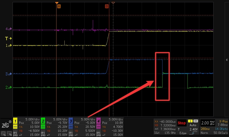

My customer is using SN74LVC1G79 and met issue during the power on.
Magenta channel 4 is the D input signal of the trigger, yellow channel 1 is the 5V power supply, green channel 2 is the clk signal, and blue channel 3 is the output of the trigger; the current phenomenon is that when the D input and clk signal of the trigger are both low, the output of the trigger will follow the 5V power supply voltage, and the duration is 7.44ms.
Q1: Is it normal during the power on and output automatically sets to high.

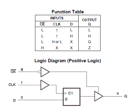

Q2: Can SN74LVC1G374 be used for solving this issue? We want to keep OE high when power on and set it to low after power on.
Q3: Do we have relevant device with opposite OEn logic vs SN74LVC1G374?
  • Hi Gary,
    This is normal. Please see This FAQ for an explanation.
    An Output Enable option seems like it may be a good choice for your problem.
    The OE logic for our devices typically works the same way. Consider tying OE to VCC using a pull-up resistor to ensure a high-Z state during power-on. An alternative might be TPLD
