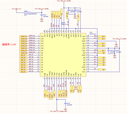

Part Number: SN74V215
Hi Sir :
Please help check if there are any issues with the schematic diagram. My application is for OTDR ;
The IO of SN74V215 has been connected to MCU
Hi Sir :
Hi Anson,
I would tie unused inputs to GND/Vcc. Other than that the schematic looks fine.
