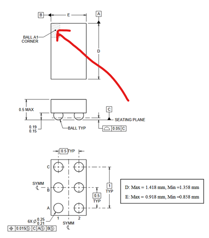

Could you help check how to match SN74LVC1G332YZPR package description?

Hi Will,
The first picture is correct. Not that it specifies that that is the view from the bottom of the chip, and not the top.
Malcolm

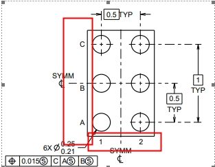

Hi Malcolm,
Thanks for your feedback.
As you could see the package mark pin as A1, A2, B1, B2, C1, C2; while the pin definition mark as 1,2,3,4,5,6.
How to match the A1, A2, B1, B2, C1, C2 to 1,2,3,4,5,6?
Will
Will,
It depends on which way the package is rotated.
A1 = pin 1
Berst,
Malcolm
