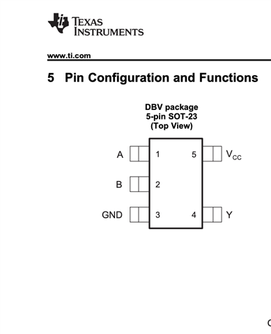

I recently ordered a board based on your KiCad diagrams, and it turns out to be defective due to flipped GND and B pins in the Schematic/Footprint.
This was quite a costly issue.
See images.
Datasheet and ultralib linked.
