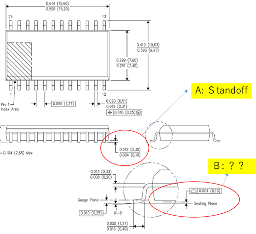

To the person in charge
Please tell me about the DW (R-PDSO-G24) on page 12 of the datasheet.
Which part of this shows coplanarity?
p/n:CD74HC154M96
Best Regards
Shingu
Hi Shingu,
We do not provide an ideal plane for much of our package specs. All of our specs come with a range of measurements if looking for the pins specifically you can see those measurements highlighted. The ideal plane can be the average between the two numbers.
Owen
Hi Owen,
Thank you for prompt reply.
Best regards
Shingu
Hi Owen,
Please tell me one more thing?
I think A means the spec of stand-off, but what does B represent?
Hi Shingu,
That is the seating plane
The reference plane that designates the interface between the package or its terminals and the surface on which it is mounted.
Owen
