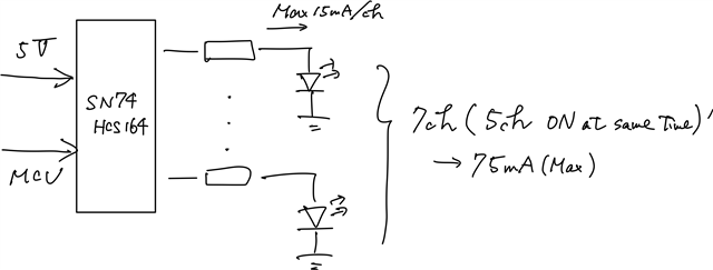

My customer need to check circuit feasibility. They will use SN74HCS164 as LED indicator and its schematic is below.
LED is 15mA/ch and total maximum current is 75mA. Can this device handle this current?
Could you also teach me how to read maximum current in datasheet?

  • The test condition for VOH is 6 mA; for larger currents, the output voltage is not guaranteed. The absolute maximum rating for the total output current is 70 mA; 75 mA can destroy the chip.
    The CD74AC164/SN74AC164-Q1 allows higher currents.
    In general, for higher loads, you invert the signal and use a low-side driver like the TLC6C598-Q1.

    They try to set total 70mA with SN74HCS164-Q1. One thing I want to confirm - 15mA/ch is possible? If you have maximum current per channel please let me know.
    Youhei MIYAOKA
  • 15 mA on one channel will not damage the device, but there is no guarantee what VOH might be in this case. You might need to use a smaller resistor to get 15 mA.
    5× 15 mA is more than 70 mA and can damage the device.

    Thank you. What is the maximum voltage the customer shoud keep lower at VOH?
    Youhei MIYAOKA
    VOH is the output voltage of the device. As the device drives more current, the VOH will drop. This would affect the current through the LED, since I = (VOH - Vf)/R, where Vf is the forward voltage of your LED. Effectively, this means you will need a smaller resistor than expected to get 15 mA on the output, but TI does not guarantee VOH at that high of a current draw, so the exact resistor size would need to be determined experimentally.
