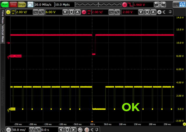

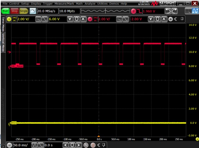

    Back to basic  here are below 2 oscilloscope captures, exact device used is TPS36CD40EACDDFRQ1 (device marking NLHOV) : can you please confirm that the timing between 2 reset when the TPS36 may not be receiving any WDI is expected ? can you please break it down to see what orderable we may need to tweak this or that knob ?
    Also one of the theory is that the MCU doesnt have time to boot up and send the WDI before the TPS36 issues a reset again
    working :
    not working (WDI cant be probed, as when probed not only does it look correct, but the system is back and running up until we remove the probe and the MCU resets again)

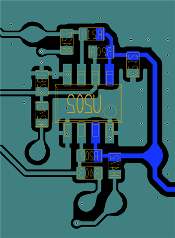

  •  can you please send your layout ?

    Per your call with Sila it looks like adding any sort of pullup/pulldown fixes the issue. Due to this it seems the MCU has enough time to startup and provide the pulse. Like  was stating it looks like a latchup condition, however this should not be possible given the input topology of this WDI pin. Regarding this I will share additional TPS36-Q1 device information over email.
    As a solution for the time being I would recommend the pullup resistor be populated as this fixed the issue and provides no concerns with our device. It would be best if we could also remove the TPS36CD40EACDDFRQ1 device from the board and test it on an EVM to isolate if this issue is due to the watchdog IC.

    Refdes are as per the schematics above. Please let me know if you would like to see all the layers.
