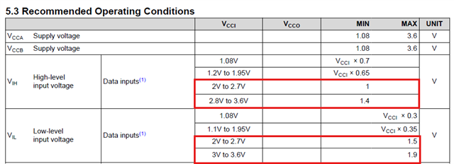

I believe i may have found an error in the datasheet for SN74AVC4T774-Q1.
In this, in the sections highlighted, it specifies a VIL greater than VIH. Where these logic levels cross over this would lead to an undefined state at the output. For example, at a VCCI of 3V, there would be no way to predict the state of the output if the voltage at the input was between 1.4V and 1.9V.
Could you please confirm what the values should be?
