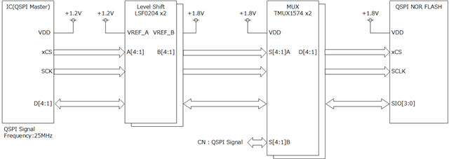

We are considering the LSF0108 and LSF0204 for level conversion with QSPI NOR FLASH.
Are they usable under the following conditions?
Voltage: +1.2V (QSPI Master), +1.8V (QSPI NOR FLASH)
Speed: 25MHz
Other: Signal switching via MUX (TMUX1574)
If there are other level shifter ICs that can meet these requirements,
could you please let us know?
  • For 25 MHz signals, the LSF requires very strong pull-up resistors. The two QSPI device probably do not have enough drive strength for this.
    For the unidirection signals (/CS, SCK), use the SN74AXC2T45. For the bidirectional signals, use the TXB0304.
  • Hi Higuchi-san,
    Clemens is correct here. For more information regarding level shifting QSPI applications, please reach out to your local TI contact and we can continue the discussion offline.
