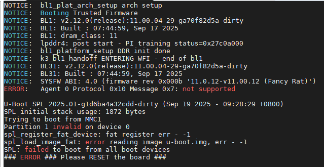

I am using the AM62L PG1.1 CPU, and TF booting is normal, but emmc booting reports the following error.
The phenomenon is the same when verified on the uboot source code of SDK11.00.15.
  • Hi, could you please clarify the method followed for flashing the images to the eMMC?
    I use a script in the ramdisk to flash images.
    The currently available AM62L SDKs doesn't have the support for booting from the eMMC boot partitions. After the fixes in AM62L SR1.1, the support is recently added in the U-Boot.
    Please see the following response:
    https://e2e.ti.com/support/processors-group/processors/f/processors-forum/1556647/am62l-emmc-boot-failure-in-reduced-pin-mode/6002719
    Please checkout the tag "11.01.12" as mentioned in this response and try booting.
    Thanks!
