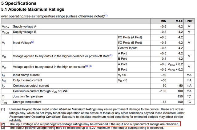

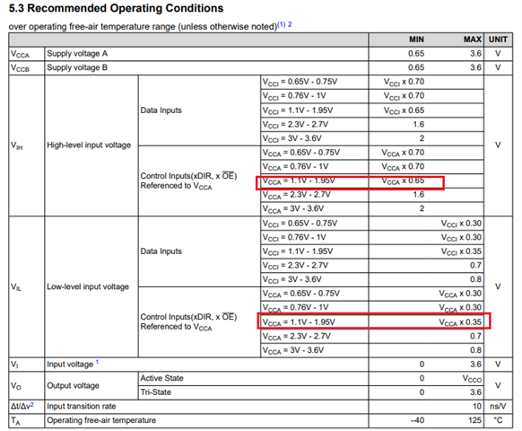

Hi team,
Could you kindly help check below application scenario if is ok? The VCCB is 1.8V supply and the 2B1 input is 3.9V high.
I checked the high-level and low-level input can meet our requirement, and high-level input doesn't over 4.2V.
Thanks!
