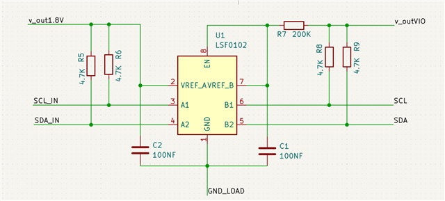

Part Number: LSF0102
Hello
How to use LSF0102 for UART.
I can't get correct readings with it, using TXB0104 works fine, but I need to use LSF0102 in this project.
I'm not using pullup resistors on LSF0102.

Hi Marcelo,
Is there a reason why the pullups cannot be used with the LSF0102? The device has open drain outputs, and would need external pullups to achieve the logic high state especially on the higher voltage side (B1/B2).
Jack
This depends on the maximum signal frequency and the capacitance of these traces on your board. 4.7 kΩ should be OK.
The frequency is 115200 it seems that I have an impedance problem at input A1 and B1
Hi Marcelo,
115KHz is supported by the LSF0102 as the frequency is achieved via the external pullups selected.
Can you please help clarify with continuity checks/ ABA swap to see if potential soldering issue? Otherwise please provide waveforms of signaling of A1/B1 for further debugging.
