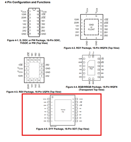

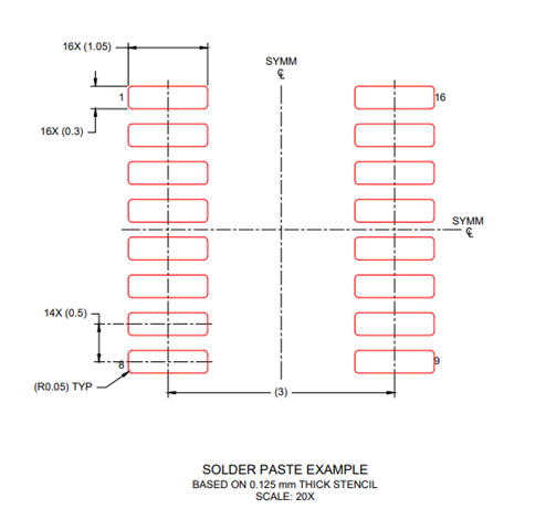

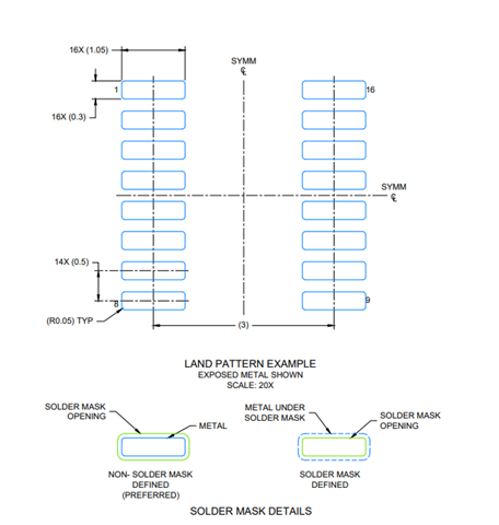

I was referring the SN74AVC4T245DYYR datasheet to create the symbol and footprint, but I found an error in datasheet regarding the thermal pad. In the section: Pin Configuration and Functions, its mentioned the thermal pad for this part number but not mentioned the thermal pad dimensions in the package, land pattern information.
Could you please help me here?
Here are the snapshot fyi.
