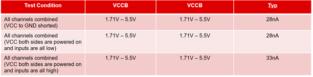

[FAQ] What is the leakage between 2 grounds?
Other Parts Discussed in Thread: TXG1041
FAQ: Logic and Voltage Translation > Ground-Level Translators >> Current FAQ
The leakage between two grounds can be found under the Electrical Characteristics section in the datasheet.
Using the TXG1041 datasheet, as an example, the leakage values are:
