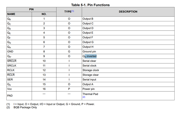

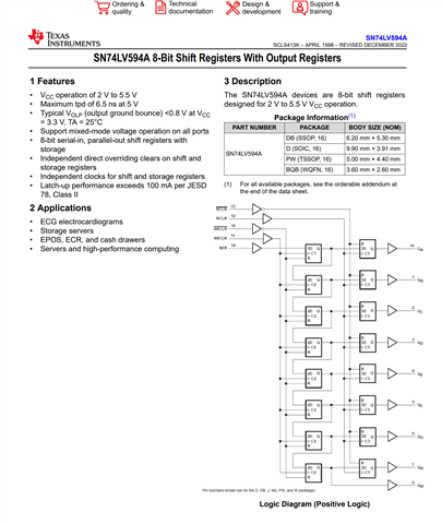

For the TI SN74LV594A, the equivalent circuit diagram in the datasheet shows the Qh' signal, pin 9. However, the pin description in table 5-1 says that the signal Qh' is inverted. The timing diagram in figure 6-1 does not suggest inversion, nor does the equivalent circuit diagram. Is this a typo in the datasheet? If so, could it be updated?
