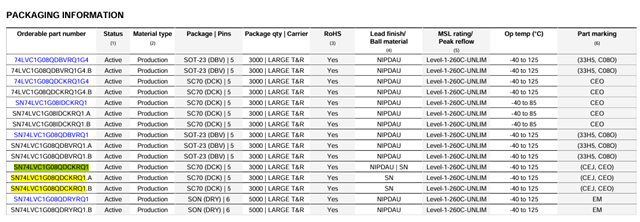

hi expert
whether is temperature only difference between SN74LVC1G08IDCKRQ1 and SN74LVC1G08IDCKRQ1?
thanks

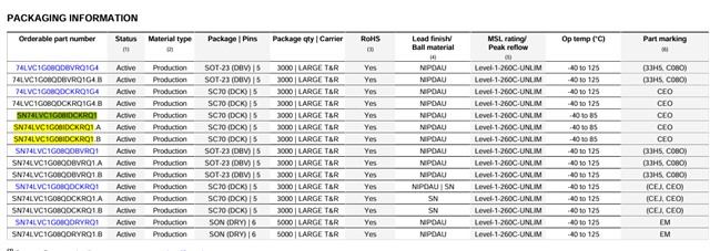

I see, you meant the SN74LVC1G08QDCKRQ1 vs. SN74LVC1G08IDCKRQ1.
The only differences are temperature range and then a slight propagation delay (Tpd) difference, as well as the possible finishes (one is only NIPDAU, the other can be NIPDAU or SN).
