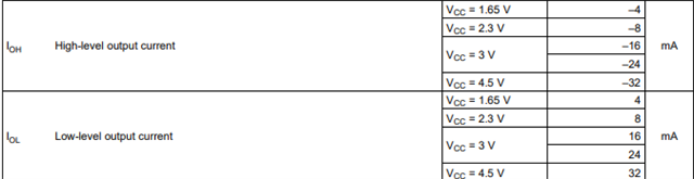

Hi E2E,
The dstasheet of "SN74LVC2G17 " didn't mention if this is push-pull or open drain device.
Could you double confirm if "SN74LVC2G17 " is Push-pull buffer?

Hi Janet,
This is a push-pull device.
The way to tell in the future if it's not directly mentioned is in the Recommended operating conditions
Push-pull
Open-drain
