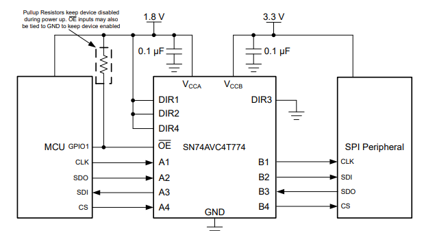

Hi Joshua,
Is it possible to calculate the power dissipation using the operating voltage and current?
Taking the following circuit as an example, what is the approximate power dissipation during operation?
I want to back-calculate the Tj parameter.

Hello Allen,
I do apologize for the delay on this.
If you are trying to calculate the power dissipation during normal operation then we need to use the following:
Total Power = Static Power + Dynamic Power + Capacitive Load Power Consumption + Resistive Load Power Consumption.
Additional information can be found here: FAQ. Power consumption calculator can also be found there.

Hi Joshua,
What are the total power dissipation values for SN74AVC4T774RSVR and SN74AVC2T245RSWR?
Parameters as shown in the figure below
Hello Allen,
The total power dissipation that Nexperia uses is calculated from the package thermals and not operating voltage and current. The Ptot below is taken from 74AVC4T245 (Nexperia)
This goes back to the FAQ I shared in my first post.

Hi Joshua,
At an ambient temperature of 45 degrees Celsius
Temperature measured :
SN74AVC4T774RSVR package: QFN6, Tc max= 88.7°C
SN74AVC2T245RSWR package: UQFN10 , Tc max= 72.4°C
What is the approximate Tj value of the two ICs at this point?
What is the approximate value of Power Dissipation?
Hello Allen,
TJ max would be 150C
Using the formula: Pmax(W) = (TJ(max)(°C) - TA(max)(°C)) / θJA(°C/W)
SN74AVC4T774RSVR: [(150°C - 125°C) / 139.2 C°/W] = 179mW
SN74AVC2T245RSWR: [(150°C - 125°C) / 227.4 C°/W] = 109mW
Josh
