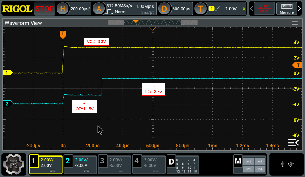

IO7 should be Z (means H with the external PU) from the startup until controlled RESET event. But burned TPLD1201 outputs 1.15V:
Please note that IO7 connected 10k PU to TPLD's VCC only.
I can understand that IO7 is under high impedance during TPLD startup time; 245usec. Why did IO7 output 1.15V?

  • Hi Yasunori,
    Do you have an external PU or PD on this pin? The way a high impedance output works is that the voltage will be a floating/"unknown" value between 0V to VCC, but there is no current drive. If you add an external PU or PD resistor just for testing, the voltage during the 1.15V step you are seeing would be driven by the resistor instead.
    Malcolm
  • Hello Malcolm,
    Yes, 10k PU is external of TPLD1201, to connect IO7 with VCC of TPLD. Here's a test environment:
    I was expecting that IO7 will be 3.3V because IO7 is high impedance during startup time. But the oscilloscope CH2 showed 1.15V. Please refer the previous screenshot.
    Could you explain the result for me?
    Yasunori Okutsu

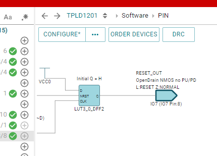

  • Hi Yasunori,
    A few requests:
    1. Could you see what happens if you connect the input of pin IO7 to a couple of different things, such as VCC, or POR?
      1. If possible, it would also be helpful to test this normal case while connecting POR to a separate output pin and including it in the scope shot. Seeing when POR goes high would indicate to us when we expect the start-up sequence to have completed.
    2. Could you share how you are testing this, for example on an EVM, prototype board, etc.
    3. Could you share the version of ICS you are using?
    4. If possible, could you share a screenshot of the internal configuration of LUT3_0_DFF2?
    If I have these details, I can try to replicate the issue. The obvious conclusion is that something is driving the pin low, but I'm not sure why that would be happening right now.
    Malcolm
  • Hi Malcolm,
    You wrote: (red text)
    This means, I should burn special one and test. I will try later.
    My writing environment;
    Win11 PC - TPLD-PROG - TPLD1201-DGS-EVM
    Programmed TPLD1201 is tested at:
    TPLD1201-DGS-EVM(with burned TPLD1201) P2 - Our Functional tester ( to provide VCC to EVM )
    Please refer also my previous post.
    Of course, I remove all the jumper pin from TPLD1201 to EVM board circuit. And used J1 to connect EXT_VCC and EVM VCC.
    At the same environment, here's another result:
          Pin Setting             Initial Output  External PU
    IO7 Digital Output / NMOS OD         H           YES
    IO6 Digital Output / PushPull        H           NO
    IO5 Digital Output / NMOS OD         H           YES
    IO6 and IO5 output normally. Especially IO5 goes high from VCC startup using the external PU. I think only IO7 has low output at the startup time.
    At current, IO7's behaiviour is acceptable for us. But I want to know the reason.
    Yasunori Okutsu

  • Hi Yasunori,
    Here is what I see on my test, using 10k external pull-up. Perhaps the device you are testing on the board has been damaged in some way.
    Malcolm
  • Hi Malcolm,
    I see and will check my board again. Thank you very much.
    Yasunori Okutsu
