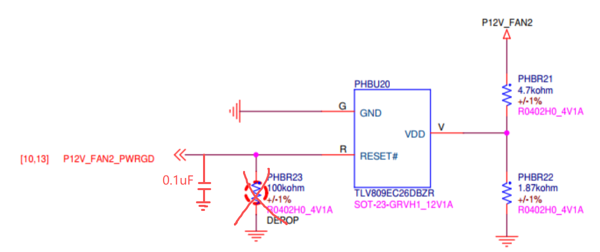

We are currently utilizing the TLV809EC26DBZR in our circuit design and have encountered an issue where the Reset pin frequently fails to output a High signal. In our configuration, the Reset pin is connected to a CPLD input and includes a 0.1uF capacitor to GND.
To diagnose the issue, we conducted the following experiments:
  1. Removed the TLV809E and added a 100k pull-up resistor: The High signal was output correctly, confirming the CPLD input is functional.
  2. Connected the TLV809E VDD pin directly to the 3V3 rail: The Reset pin functioned normally (High).
  3. Reduced the resistance values of the original voltage divider: The Reset pin functioned normally (High).
  4. Removed the 0.1uF capacitor from the Reset pin: The Reset pin functioned normally (High).
Based on these results, we suspect that the charging current of the Reset capacitor causes a voltage drop. When VDD is supplied via a high-impedance resistor divider, the voltage may momentarily dip below the threshold, causing the device to reassert Reset.
Could you please clarify whether the TLV809EC26DBZR supports divider-fed VDD, or if it is strictly intended to be supplied by a low-impedance power rail?
We look forward to your professional feedback. Thank you.
    We do not recommend using an external voltage divider to supply VDD on TLV809E for supply current and accuracy reasons. It is intended to be supplied by a low-impedance power rail. Additionally, please note that the maximum recommended current for the reset pin of TLV809E is +/-5mA.
    If an open-drain output is acceptable, I recommend using a device such as TPS3842 for this application as it supports using an adjustable threshold utilizing an external voltage divider and can be supplied with up to 42V.
