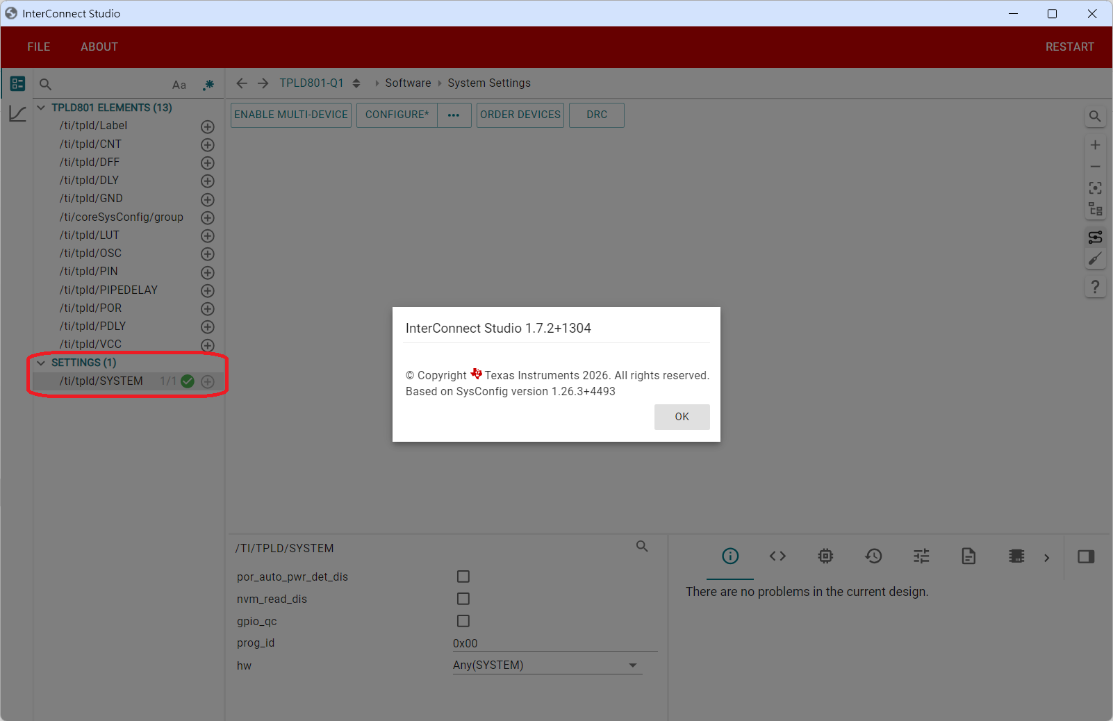

I noticed that Interconnect Studio version 1.7.2_1304 is missing the simulation function, whereas version 1.6.0_1155 had it. Could you please look into this issue?

Hi Kuo,
On the latest version of the tool, you need to click "Enable Multi-Device" first in the top left, and then you will be able to perform simulations.
