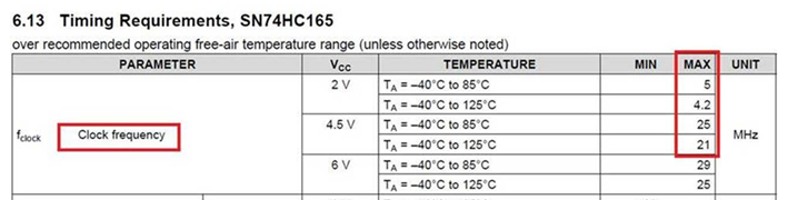

Hi team,
Please help with the customer's questions of SN74HC165PWR spec below
1. Which clock frequency standard is Min/Max on the Datasheet?
2, They currently set clock frequency =6MHz(3.3VCC), is it within the spec?
3, According to 6.13, what is the frequency spec at 3.3Vcc?
  • Hi Roger,
    1. The switching fmax (min) is the largest frequency that we guarantee our part can output. It is the smallest guaranteed frequency maximum. If you output a frequency over that minimum, it is not guaranteed. I agree the wordage is confusing, but it is industry standard.
    The fclock maximum is the maximum input frequency that we recommend inputting to the part.
    2/3: For value between those in the datasheet, TI recommends linear interpolation. This gives an fclock max of 12 MHz at 3.3 V.
