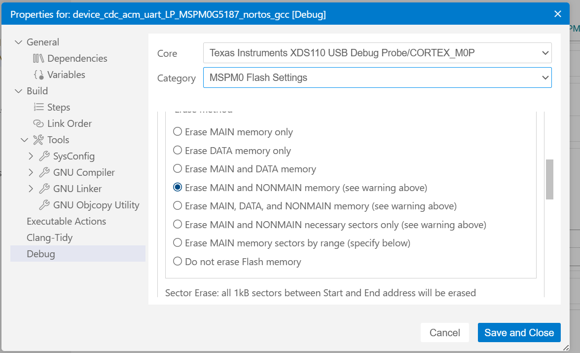

We need to flash the firmware via TinyUSB on the MSPM0G5117 MCU, which belongs to the same family as the MSPM0G5187.
As suggested by the local TI team, we added the Config NVM settings and modified the BSL Invoke Pin configuration accordingly (reference image attached). Additionally, under:
Project → Properties → Debug
the checkboxes for both Main and Non-Main memory erase were enabled before flashing the code.

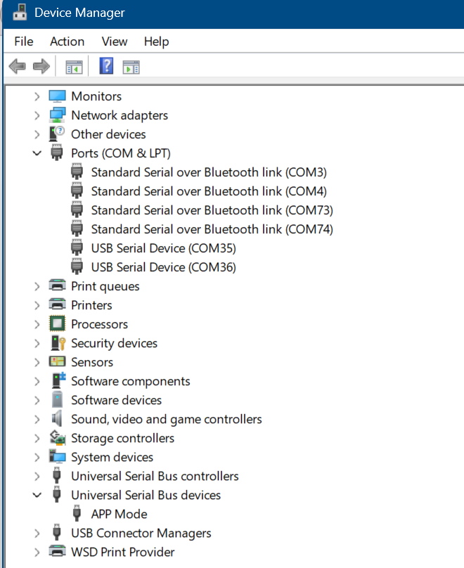

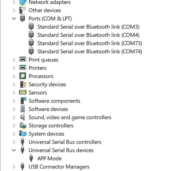

After flashing, we are following the below BSL entry sequence:
  1. Hold the BSL button
  2. Hold the Reset button
  3. Release Reset after 1 second
  4. Release BSL after 2 seconds
However, the COM port is not becoming visible, and the system is not entering DFU mode as expected.

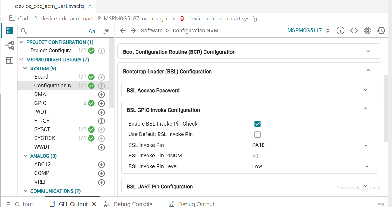

In our case, Config NVM modification is mandatory because, by default, BSL mode is triggered using a HIGH signal. However, based on our hardware design, the trigger must work in LOW condition, which is why the Config NVM changes are required.

Before Inoke sequence
After BSL Invoke Sequence
  • Hi Ramanathan,
    There is no need to config NVM for BSL mode. We enable the BSL/DFU mode by default. Please execute factory reset to recover the device to blank.

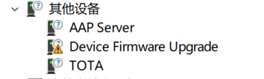

    Entering into BSL / DFU Mode
    • The device is not reliably entering DFU mode after the configured button sequence.
    • COM port is not getting detected after the BSL invoke sequence.
    The flow is correct, while the NVM is not required to configured.
    After the button sequence, users should find the Device Firmware Upgrade (DFU) show in the "Other Device"

    Validation whether the current Config NVM settings are correct for DFU operation
    MSPM0G5117 enable DFU by default, normally we doesn't require any NVM settings.
    Unless the hardware schematic uses other BSL/DFU invoke pin or polarity (default is PA18, with HIGH polarity invocation).

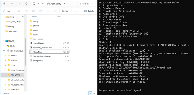

  • Hi Sal Ye,
    Thanks for your reply.
    After testing the procedure, I am facing the following issues:
    1. During the flashing process, the operation stops in the middle. For your reference, I have attached a picture.
    As per the instructions you shared, I followed the below DFU sequence:
    • Entered DFU Mode
    • Unlocked BSL
    • Entered Sample Password
    • Password Accepted
    • Started Code Flash using the .bin file (128 KB)
    However, after sending the .bin file, the flashing process gets stuck. Please share the correct flashing procedure and guide me on how to resolve this issue.
    1. During another flashing attempt, the process again stopped in the middle. After that, when I tried to enter DFU Mode again, I started getting the error: MSPM0 core failed.
    Let me know how to recover from this issue. I also tried using CCS, but the same issue still persists.
           3.Share the .bin file flashing procedure similar to the .txt flashing procedure you shared earlier.
    Also guide me on how to generate .txt or .bin files from CCS builds. Currently, CCS generates only the .out file, and I am using PowerShell commands to manually convert it. Please share the recommended conversion process and required tools/commands.

  • Hi Sal,
    Can you suggest any methods to popery generate .bin file that can be flashed?
    The observation is that hex files are working correctly when flashed through Uniflash - but non main reign gets corrupted once flashed after converting it to bin.
    we are using objcopy library to convert the files. below is the command that is being used  -
    "D:\Code_Composser\9 2019-q4-major\arm-none-eabi\bin\objcopy.exe" -O binary --gap-fill 0xFF --pad-to 0x00020000 -j .text -j .rodata -j .data -j .cinit -j .const -j .init_array -j .interrupts "FCode.out" "firmware2505.bin"

    Can we have quick call with customer to help him out here. Below is the latest status.
    1. Successfully able to generate .bin file without non main changes
    2. Successfully able to flash it through UNIFLASH.
    3. Application is workign as expected with uniflash.
    4. When trying to use DFU tool to flash devcie belwo error is occuring.
    As per your instructions, the .bin file was successfully created with a file size of 123 KB.
    After that, I followed the same flashing procedure; however, the code was not flashed successfully. During the process, after checksum verification, the operation exited without failure report.
    In the logs download is still 0 percent.
    Megh
  • Hi Megh,
    I suppose the TXT file should work.
    I also test the bin file in my side, it works with below interface log, please refer to the flow I generates, I see the command of the file name, path is not the same as mine, below is the reference:
    Welcome to Interface Utility!
    Performing initial setup...
    Checking device connection...
    data written to output file: image.dfu
    the output data written in image.dfu
    DFU download may have failed. See debug/dfu_log.txt for details.
    Getting device info...
    output file output/device_info.txt
    the send staus is 1
    Bin file path : output/readback.bin
    Output file path : output/device_info.txt
    Hex data of given .bin file has been written to output/device_info.txt
    Initial setup complete.
    Enter the choice based on the command mapping shown below:
    1: Program Device
    2: Readback Memory
    3: Standalone Verification
    4: Mass Erase
    5: Get Device Info
    6: Factory Reset
    7: Flash Range Erase
    8: Start Application
    9: Unlock BSL
    10: Toggle logs (currently OFF)
    11: Toggle send file (currently ON)
    12: Calculate file checksum
    0: Exit
    Choice: 9
    Password file (.txt) [password.txt]: inputs/sample_password.txt
    writing to file firmware_0_21.dfu with address 0
    File written successfully: firmware_0_21.dfu
    sending file: firmware_0_21.dfu
    Do you want to continue? (y/n): y
    1: Program Device
    2: Readback Memory
    4: Mass Erase
    5: Get Device Info
    6: Factory Reset
    9: Unlock BSL
    0: Exit
    Choice: 4
    1: Program Device
    2: Readback Memory
    4: Mass Erase
    5: Get Device Info
    6: Factory Reset
    9: Unlock BSL
    0: Exit
    Choice: 1
    Input file (.txt or .bin) [firmware.txt]: inputs/test_firmware_main.bin
    Enable checksum validation? (y/n): n
    Start address (hex) [0x8000]: 0x0
    Output file name [image.dfu]: test_bin.dfu
    data written to output file: test_bin.dfu
    the output data written in test_bin.dfu
    Then I read back the memory by UNIFLASH and verified it has been programmed successfully:
    Some tips:
    1. mass erase before load new firmware
    2. make sure the file name and path is correct
    B.R.
    Sal
  • Hi Sal,
    Thanks for the support here.
    This resolved the issue and Ramanathan is testing few more configuration now. We will reach out to you I any thin is required.
