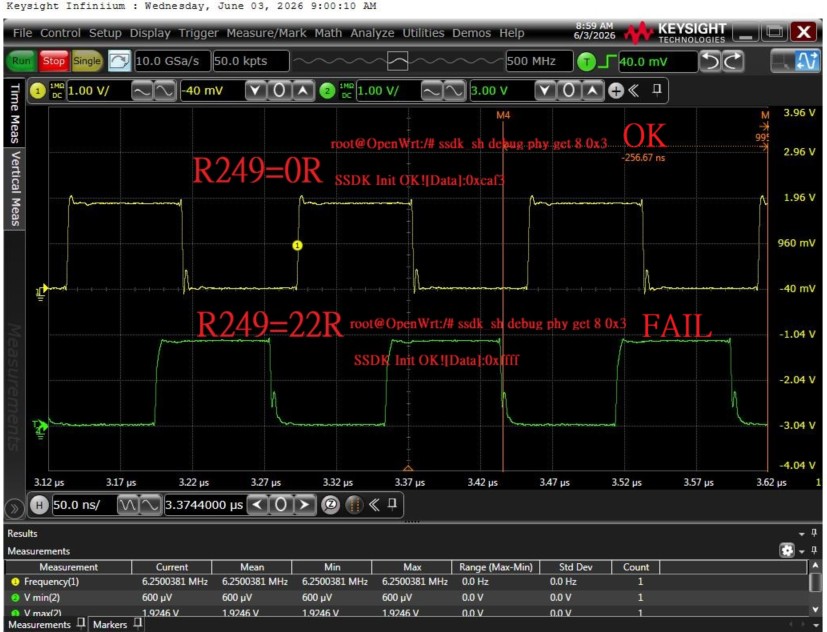

Hi Team,
The factory reported that the TXS0102DCTR received material has two different marks.
When the NG mark material is used, the TXS0102DCTR fails to function properly.
 OK  marker: 35UT                          NG: NFE
                         631X                                     5CR
