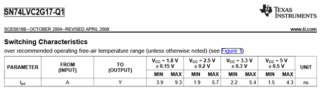

Hi Can you please provide
1) typical , min and max value for VIH and VIL for VCC-5V
2) tplh and tphl values

Hi Pranjali,
1. This is a Schmitt-trigger device, so it has VT+ and VT- thresholds instead of VIH and VIL.The switching threshold is different when going from going from high-to-low and going from low-to-high.
2. tph can be considered the maximum value for both tplh and tphl.
More information about both of these values can be found at Understanding and Interpreting Standard Logic Datasheets.

Can you please provide below value at 5V
1) typical value for tpd
2) tplh typ, min and max value
3 )tphl typ, min and max value
Hi Pranjali,
You may take the tplh and tphl to be the same as tpd.
Typical can be considered the middle of the two values.
