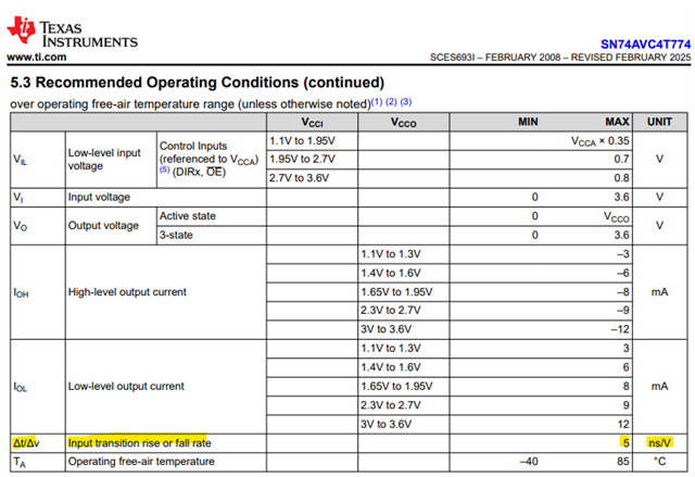

Is there input slew rate requirement for this device? you can see following image, the input is slow, output has jitter.

Yes, there is a input slew requirement: 5ns/V or less
