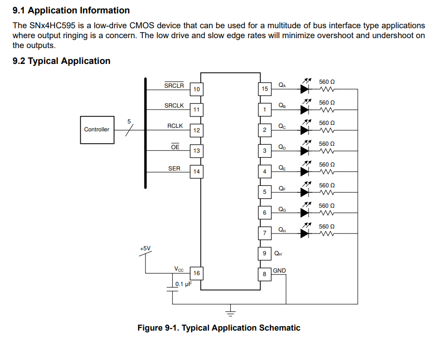

We want to use SN74HC595 to drive seven-segment numerical tube LED as below.
Each moment, they will only drive one segment for 100us. But they need 20mA current. Which means each time there is only one output of SN74HC595.
Q1: Do you have test data that if SN74HC595 can support 20mA/3.3V for long term(up to 3years)
Q2: If 20mA is not allowed, what is the maximum value of current?
  • The absolute maximum rating is 35 mA, so the device will not be damaged. But for output currents above 4 mA, the output voltage is not guaranteed.
    You could add a strong buffer like the SN74LVC541A. Alternatively, use the TPIC6B595 and drive the LEDs from the cathode.

    Customer wants us provide the test data of lifetime if they use below two situations:
    1. 8ch output driver(4mA) at the same time, which can keep IC's health for 3years?
    2. Only 1ch output driver(30mA) for 100us and then turn to another channel, which can keep IC's health for 3years?
  • In both cases, the absolute maximum ratings are not being exceeded, so the lifetime will not be reduced at all.
