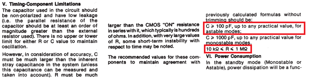

We are designing to use CD4047 Astable mode Q output at 278KHz. When we use R=8.2K ohm and C=100pf, the theoretical output Q is 278KHz. However, we found that Q is 231KHz in actual testing. When we replace it with higher precision resistors and capacitors, the frequency does not change much; We suspect that the deviation is caused by parasitic capacitance inside the chip, but I did not see the parameters of parasitic capacitance in the specification sheet;
We would like to know the recommended values for R and C in Astable mode  operating mode; What are the factors that affect the output frequency?

    Internal Input Capacitance (C_IN): The datasheet notes that the typical input capacitance is 5 pF (and can be up to 7.7 pF). When using a small 100 pF external timing capacitor, this internal capacitance—plus another 5 to 10 pF of stray PCB trace capacitance—adds directly in parallel. This tricks the chip into acting as if your capacitor is actually ~115pF.
    Propagation Delay (t_PHL, t_PLH): This is the main bottleneck. At a standard supply voltage of V_DD = 10V, the internal propagation delay from the astable inputs to the Q output is typically 225ns (and can be up to 450ns). At V_DD = 5V, it stretches to a massive 500ns typical. Every half-cycle, the chip takes an extra couple hundred nanoseconds just to process the transition and flip the output, which permanently stretches the total clock period and caps your maximum frequency.

    To achieve the best stability and line up with the theoretical formulas without manual calibration, the datasheet outlines strict parameters for the RC network on page 7:
    The timing capacitor (C): Must be ≥ 100pF. However, using exactly 100pF pushes right against the boundary where stray system capacitance skews the math.
    The timing resistor (R): Must be between 10kΩ and 1MΩ. Your current value of 8.2kΩ falls below the recommended minimum. Dropping below 10kΩ forces the chip to drive too much current through the internal RC common node, distorting the internal switching thresholds V_TR.

    If you must stick with the CD4047B, you will need to abandon the pure theoretical formula. You can scale down your resistor value (or use a potentiometer) to "overclock" the RC network, effectively forcing the lagging chip to switch fast enough to hit exactly 278 kHz. This will be best done on the bench by trial and error.
