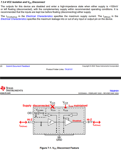

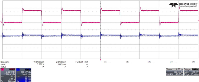

Hi All,
I have a question about SN74LV1T34.
When the VCC pin is left open and a 3.3V signal is applied to the input, the input voltage back-feeds into the VCC pin, resulting in a voltage of approximately 3.0V.
To prevent this back-flow to the VCC pin, a 47kohm series resistor is placed on the input line.
Is there any issue with installing a 47kohm series resistor on the input?
