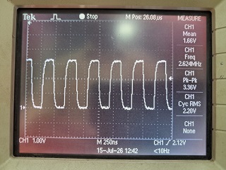

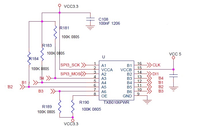

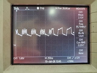

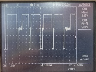

I am using TXB0106PWR for converting 3.3v to 5.V logic levels, facing challange in getting clean output
all signals are uni directional o/p of 3.3V microcontroller system with CLK signal is less than 6MHz
please find the attached schematic for the same
let me know possible rootcause & solution for the same , also let me know if any other dropin replacement available for the same
