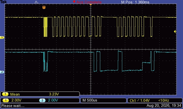

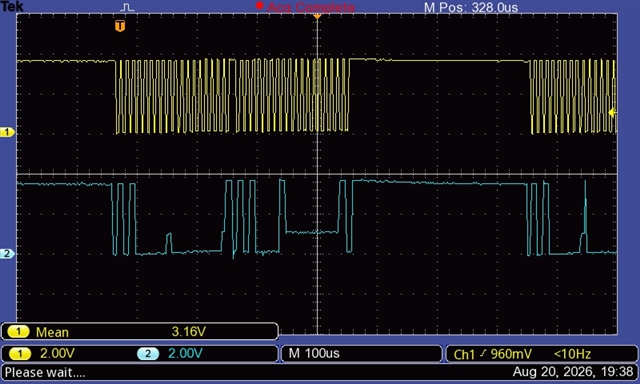

  • Hi Jack,
    I have attached the image of working below,
    And below is the non-working case,
    Irfan
  • Hi Irfan,
    I do not see any glaring differences between working/ non-working waveforms. Could you help confirm? (Even with the working waveform, it seems that a glitch is also visible). If we want to move away with the one-shots that are driving the strong transients during edges, the LSF0102 can also be eval. in place of the TXS0102, however external pullups would be needed.
    Jack
