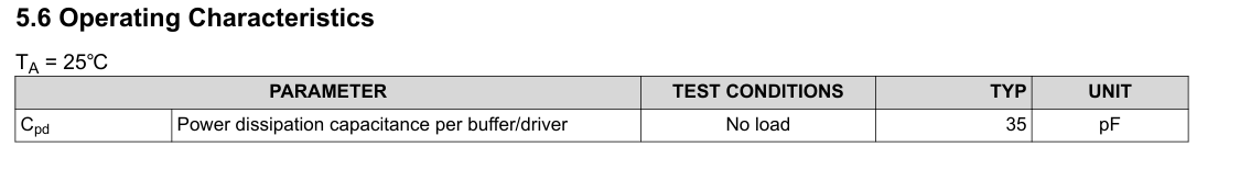

Part Number: SN74HC244
need power dissipation for the part number SN74HC244QPWRG4Q1, in ds it is for per buffer
Hi Duarunah,
Please refer to the following FAQ on calculating a devices maximum power dissipation. [FAQ] Where do I find maximum power dissipation for a device?
