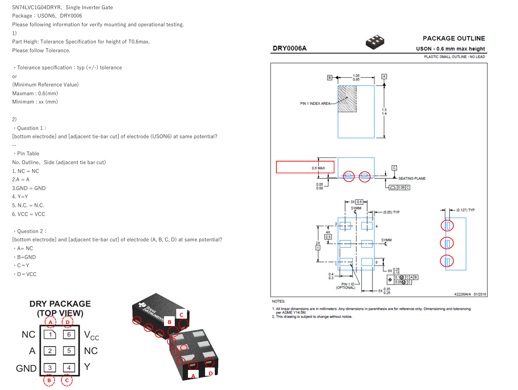

Target device is SN74LVC1G125DRYR
Customer need the following information for their assembly process and device registration. Pleasee answer it

Hi Nomura-san,
The DRY package in your image is for the SN74LVC1G04. For the LVC1G125 I have screen shotted the top of the package below.
To answer your two questions. Yes they are all at the same potential.
