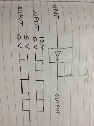

I have a sensor (File Attached) that gives me a digital signal with high (12 V) and low (0 V).  However, my Digital Input module (File Attached) can only go up to 5 V.  Thus, I need to somehow convert the signal coming from the sensor into 5 V.
Following is what I have right now
I am using ULN2004A to convert a high signal from the sensor (12 V) to a low signal of 0 V and a low signal (0 V) from the sensor to 5 V using a pull-up resistor. The schematic is attached below.
What I am interested in is if there is a better and easier way to achieve what I am doing here.
Please Advise.
