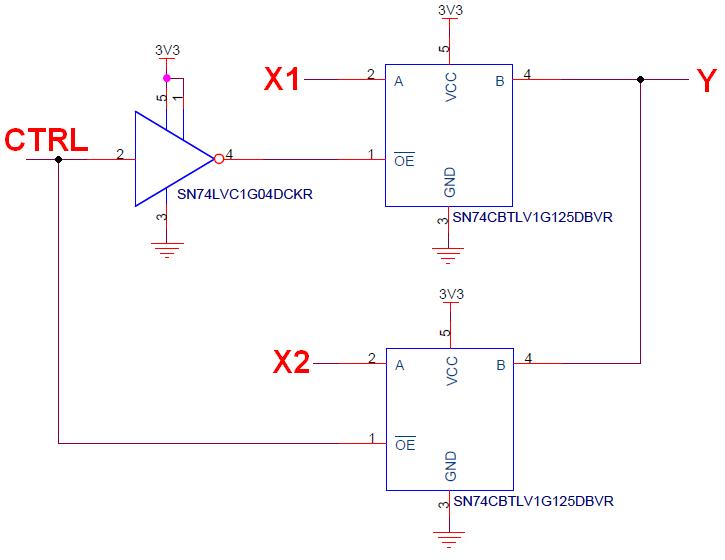

Hi all,
We need to mux incoming two fast signal with tiny components.  ___2G157 part seems to be ok but they have max. 4ns propagation delay.
So I wonder if can two SN74CBTLV1G125 be used as figure below. This device has max. 0.25ns tpd.
According to datasheet SN74CBTLV1G125 has isolated during power up. So there will not be a problem on power up but what about CTRL switching?
CTRL signal can only toggle once on boot time. But  Ten / Tdis delays are 4ns. This means output of the two SN74CBTLV1G125 can be shorted approx.4ns.
I can not insert any resistor on X1 / X2 paths or extra logic or delay for OE inputs. Will I have any problem with this configuration ? Is there any other fast LL 2:1 mux solution that you can advice?
