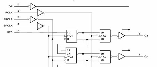

1. The data sheet states that the storage clock is a "D-type storage register". I'm assuming that it means "based on a D-type flip-flop".
Here is the relevant section of the datasheet:
But the Wiki explanation of flip-flops gives a slightly different appearance for a D-flip-flop -
One data input, one clock, one each of set/reset, and Q and Q complement.
Am I right that when it says "D-type storage register" that it means "based on D-type flip-flops"?
Does the appearance (number of connected leads) of the flip-flop matter?
 Or do the workings (logic table) of the flip-flop determine its name?
2. I can't find anything in the datasheet regarding the type of flip-flop that is used in the first level shift register.
Based on its leads, it seems like it would be a classic "D-type" flip flop. Is that right? Or is it another type?

  • At its very basic configuration, a D flip flop has a data input D, an output Q and a clock. Additional optional pins are set, reset and not Q.
    I must tell you that the device you are commenting confused me, since it seems to be that the output of the first flip flop is sent, not to the Q input of the next one, but to the SET input of the next one (and the inverted output to the reset input). So it is not the traditional implementation of chaining data out Q to next data in D. Additionally, it has two independent clocks, one for shifting, one for storage.
    Did you check other registers, like the CD4094? Its datasheet if more old fashioned, but it has the Q-D-Q-D chaining, and latches for data storage.

    So I guess a flip-flop is not necessarily defined by its pinout, but rather by its "function" or logic table.

    Regarding the FF I agree with you, basically a FF is defined by its functionality.
