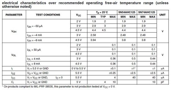

Hello:
I am intending to use the SN74AHC125 on a new design for level-shifting.  The table below shows an ICC value of 40uA max across temperature.  I have a couple questions:
1)      Does the ICC value represent the quiescent current draw of the part?
2)      Does this ICC value represent current for all four channels or is it 40uA per channel max = 160uA max per device?
Any feedback or input is welcomed and appreciated!
Thanks again!
