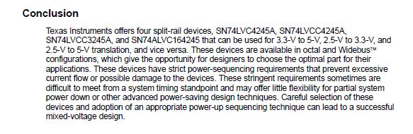

We connected the VCCB to 5V and VCCA to 3.3V.  Our power sequence has the 5V coming up before the 3.3V.  Does item#2 “Power up the control side of the device (VCCA for all four of these devices) implied that there is a power sequence involve that requires VCCA up before VCCB?
Furthermore, it recommends the OE pins be tied to the VCCA, whereas we have it connected to GND - I assume this is OK?

      First, apologies for the delay in answering this question, I wanted to be sure there were no alternative "well, you could do this" answers.  To be sure, the datasheet is stated correctly and very direct.  In addition, a supporting App Note, SCEA021A is even more emphatic about the power-on sequence, also explaining that damage could occur if it is not followed:  www.ti.com/lit/an/scea021a/scea021a.pdf .   Refer to pages 7 > 12, and in particular, the statement on pg 12 about " . .  strict power sequencing requirements. . ." :
    And for their question about OE tied to GND, no, this is not acceptable.  It needs to be tied to VCCA, as you don't want the output driver to be active while the power-up is occurring.
    Yes, they will probably have to add some supervisory or sequencing circuitry, and that is the overhead required when using these translators.
