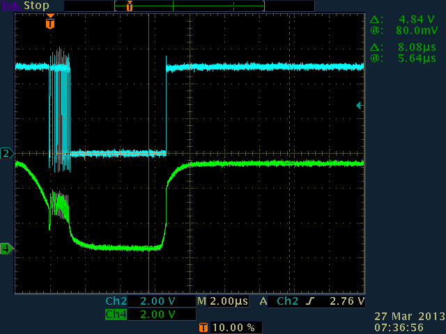

  • Hi Brian
    i am using the same kind of setup. the TXS chip has to level traslate 3.3V <-> 5V for both push-pull and open drain IO's. But i am facing issues with this chip while translating push-pull IO's , the output starts to oscillate. For open drain IO's it is working fine. I have not used any pull ups on the lines.
    we have 7 seven such lines , 2 were working fine for both the IO's , remainig 5 only works for open drain IO's. Do you have any suggestions to resolve the issue. Will the TXS are designed to drive high capacitive loads ( >70pF)? the drive strength should be >2mA to drive the TXS chip also?.
