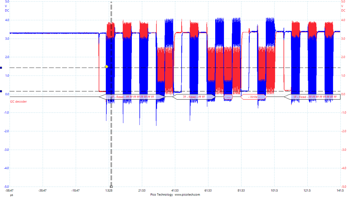

  • Here is what it looked like when the buffer went into the unstable state. This is from the perspective at the end of the long cable.
    1 = I2C clock, 2 = I2C data, 3 = 3.3V power.
    There is a lot of ringing present, as we are using long lines and there is nothing in the way of termination on the line on the far end.
    Also, the ground connection is ~20cm (as I was troubleshooting this inside our hardware enclosure) so I believe that is contributing to the oscillation seen on the power trace line through the scope. I am pretty sure the power line is stable throughout.

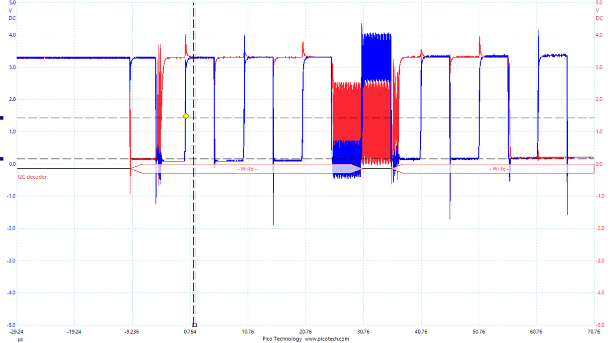

    Here is a shot of the normal I2C traffic over the (still long) shielded cable:
    I believe the problem is fixed with the other cable, but I'm not 100% sure until we build up a few more... We've been running more tests on this same device and haven't experienced this behavior again.
    Kevin
  • OK, even using the other cable didn't solve the problem, so the capacitance must still be causing problems. We are now just going to hack an i2c buffer into the cable instead (PCA9515) which is working, and just use this on the board on the next rev.

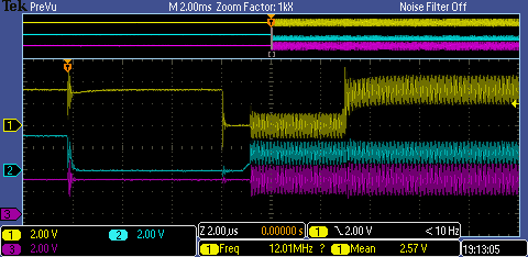

    I'm seeing a similar symptom, also with TXS0108E and also with I2C.
    We drive I2C from the TXS0108E over a 1m cable to device A, with a possiblity to daisy chain another device with another 1m cable.
    VccA rail is 2.5v and VccB rail is 3.3v (this is the device side).
    If only device A is connected then the signal is clean (apart from acceptable reflections), as soon as I add device B or even the daisy chain cable, the oscillations start. They might stop for a while and then start again. There are a couple of examples below:
    Blue - SCL
    Red - SDA
    I believe only one line oscillates and the oscillations couple through the common return to the other line, however, I still need to verify that.
    Can TI please comment on that?
