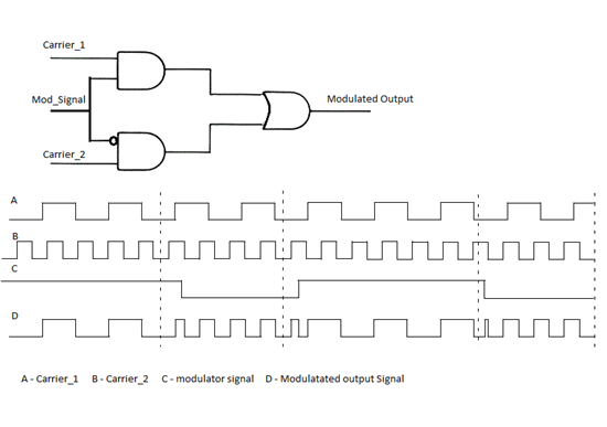

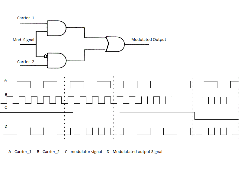

Hi All,
I genarate the modulated output signal using the following digital circuit. suppose modulated signal is the UART TX signal. Modulater circuit  generates the modulated output by anding the modulator signal with carrier_1 signal and carrier_2.
For OOK, if any one carrier signal is low, Modulator circuit generates the OOK signal.
How do I generate the FSK and PSK signal?
How do I demodulate the modulated signal?
