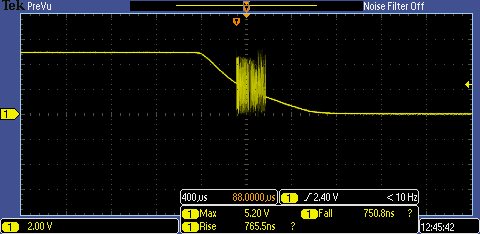

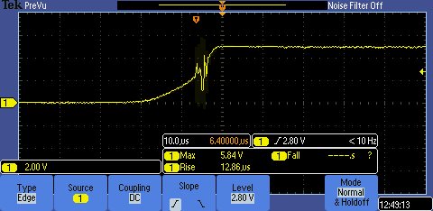

Without load (TXB0102), signal driven from opto is properly toggling to 0 and 1. But when load is provided, signal toggling is not proper i.e, while signal rise from 0 to 1 lot of noise is appearing.

     Could you post some pictures to show input and output signal when the noise happen. It will provide a lot help to analyze this case.

  • Hello Lawrence,
    Sorry for delay in response.

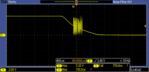

    Please find below snapshots captured at the output of opto-coupler. Please let us know your suggestions on fine tuning the circuit..

  • Hi Lawrence,
    TXB0102 is connected to Virtex-5 FPGA I/O. Power-up sequence is not there for 3.3v and 5V.
    After the unit is stable, then only we have initiated toggling of "0" and "1"..
    Kindly note that captured waveforms are at input of TXB0102.

  • Hi, Mani
    Sorry for unclear description. I want to know whether the signal source is PVDZ172N. If yes, the input is B1.
    Did  the snapshots captured at B1?
    If it is possible, please maka a testing case that enhancing the frequcecy of input singal at B1 and obseving the signal.
    Lawrence
  • Hello Lawrence,
    Signal source is PVDZ172N and input is B1.
    Snapshots are captured at B1 only.
    Presently observations are made "0" and "1"by using the external switch.
    Please let me know is the issue clear..
    Mani
  • Hi, Mani
    For TXB0102, there is reqirement on input transition rise or fall rate. The maximum of its value is 40ns/V (on page 3 at TXB0102 datasheet).
    From your testing snapshot, the input rise rate is out of range of TXB0102 spec.
    TXS0102  is suitable option for your application.
    Thanks.
    Lawrence

  • Hi, Mani
    The possible reason is the photovoltaic relay turn-on time. The long turn-on time will result in long rising edge of TXS0102 and the direction sensing function will not work well.
    Could you zoom into the input rising edge and compare it with output rising edge ?
    Please add some capacitor load on output node and observe the waveform of the input and output.
    I am looking for some part which meets the rising edge requirement. I will let you know ASAP if I get it.

  • Hi, Mani
    The TI auto-direction voltage translators, TXB serial and TXS serial, have requirement on input rise rate. If rising time is too long the glitch can be occurred at rising edge.
    The SN74LVC2T45, direction-control voltage translator, might be a choice part in your system. But there is no hysteresis function in SN74LVC2T45. Thus it is sensitive to external noise if input signal has long rising time. Then, the glitch may be occurred at output when input is noisy at comparison threshold voltage.
    The SN74AVC2T244 is with hysteresis function. But its operating voltage is from 0.9 to 3.6V on both sides. If the opto can work at 3.3V, SN74AVC2T244 is a suitable part in your system.
